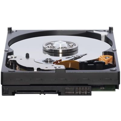

We decided on a 500GB Western Digital, http://www.westerndigital.com/en/products/Products.asp?DriveID=301
didn't realise that you had to also buy a cable to attach it to the MB, and I didn't realise that they have different connection for the power supply. The drive that is already installed has I think a four large pin connection, but this new drive has a different connection.
Here's a photo of the connections, the left hand side. How do we connect it to the PSU?  :dunno:
Re: Upgrading a Medion 8383XL.
« Reply #80 on: August 14, 2007, 12:40 »
You can get Molex (the usual 4 pin) to SATA adapters very cheaply but I would be surprised if the new PSU you bought recently didnt already have a SATA power lead.
They are quite thin black connectors about an inch wide.

Thanks Sandra, we did see
something to that effect, but was unsure if that was what it was used for, not a lot of information in the PSU manual. I expect that they believe people who buy these things also know what they are doing. :blush:
I really wish that these sorts of devices would come with connection cables, or at least the computer store where you buy the drive from, let you know that they come without cables.
The drive is in his computer but obviously not connected, not a happy boy.
