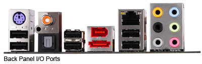

Hmm... can't find another mobo for the same sort of price that has PS2 inputs and is DDR3 compatible.  I already have both USB mouse and keyboard, and admittedly, on my existing PC, the keyboard won't work until it's loaded the drivers, which makes it impossible to use safe mode, but on other PCs, that doesn't seem to be an issue, so I assumed it was something to do with my BIOS settings.

Ah, should have read it properly the first time.  :blush:  It's only the mouse ps2 which is lacking, it seems to have a keyboard one, which is the most important, yes?  I don't think the lack of a mouse ps2 would bother me, and I have also found this, which would enable me to connect my two existing ROM drives, yes?

Oh, and at the moment, I'm going for the original Asus mobo that I saw, as the Intel one doesn't even have a keyboard PS2, which at least the Asus does.  However, I'm open to persuasion, as I like the look of the Intel mobo, and it would seem to be a sensible match for the CPU.

Just looking at Intel mobos again, but most of them seems to be lacking the K/B PS2.  :(
