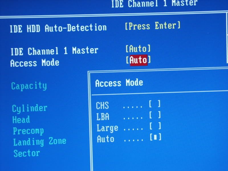

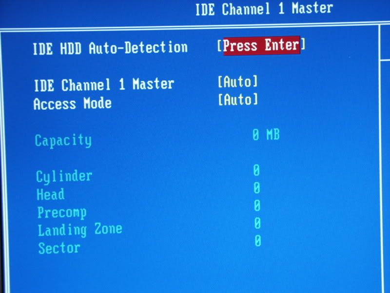

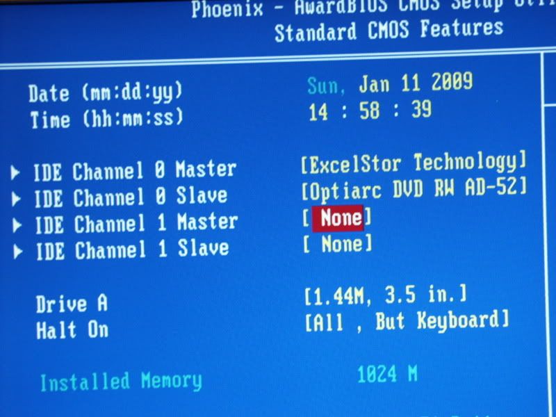

I have recently got a new computer which has vista  >:(.
It has an SATA HDD and DVD drives.
I wish to plug in my old 80Gb IDE drive so that I can either copy my data files over or leave in there as a data drive.
I have plugged the HDD into the spare mother board IDE port but I can't seam to get the BIOS to detect it.
I have the HDD set to master.
I have two cables to hand.
A very old 40 wire one
or a newer one with the blue and grey connectors
I have tried both.
Any tips ? Thank you
I have also fitted a 3.5" FDD. I have selected this in the BIOS, but I have no A: drive in vista.
I'm 99% sure I have it plugged in correctly. DO I need to do something in vista ?

You cant set a SATA drive as master or slave Sam.
You need to go farther into the bios, possibly advanced or onboard peripherals, I am not sure which it is in your bios.
With mixed SATA and IDE motherboards theres usually an option to run SATA as PATA and that should then detect the IDE drive, at the moment I dont think the mobo is enabled to support the IDE controller bcause of how its set up in bios.
If you cant see the option let me know and I will try and find the manual and see if I can tell you exactly where to find it :)

I have had a look at the manual and the bit you need is in the Integrated Peripherals press enter on the OnChip IDE Device. Unfortunately the manual doesnt show any options after that so if you cant see something to enable the IDE controller in there please do a pic of what the options are.

Thanks so much. It's working !!!!  I can read files off the HDD
I also found the FDD controller enable/disable option so that is working too
I feel such a fool for not having a further look around the bios.  :blush:
