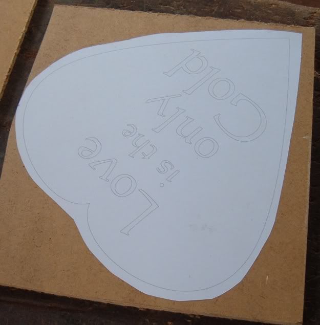

I designed the pattern and stuck it to MDF using repositionable adhesive spray:

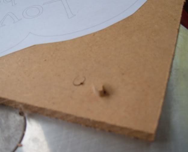

Then I drilled a pilot hole in some waste wood and made a couple of test cuts to see what be the best angle for the thickness of board and the kerf of the blade I was using.  It's a bit hit-and-miss, but I decided to set the angle at 5 degrees:

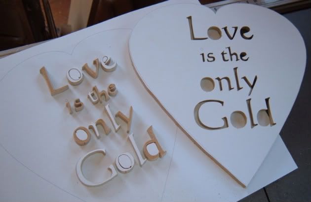

Then I tilted my saw table so that it fell from left to right and I sawed out the letters!  I cut out the middle of the letters 'o', 'e' and 'd' first, making sure I cut counter-clockwise so the middles would drop down and eventually be flush with the baseboard.  Next, I cut the outsides of all the letters, cutting clockwise so that they would be lifted above the level of the baseboard.  If you can't get your head around this, don't worry - all will become clear as the project progresses :) .  So now I've been left with a heart-shaped baseboard and a collection of letters:

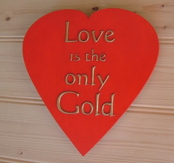

This is how it turned out in the end:
The pilot holes for the scroll saw blades are a little more conspicuous than I would like, but heigh-ho, pilot holes are always present on projects like this.  Maurice reckons it's okay, though.
If I get time I might try this pattern again using a slightly different production technique which will leave the lettering recessed, just to see what it looks like :) .
Looks great, Gill, you must be very pleased.  :thumbs:
wow - that's really nice :-)
  • Posts: 78071
A lot of thought and effort on your part Gill.  They will love it!
