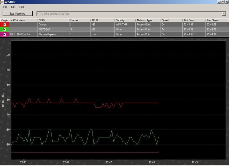

This might help, Andy:  http://www.download.com/InSSIDer/3000-2085_4-10848357.html?tag=mncol
Are you familar with this tool. I installed it, and I think it put it somewhere in program files, but I can find it / see how to run it ?  :blush:
I've just installed it on XP and it appears in the Start Menu > All Programs list, under 'Metageek'.  However, when I tried to run it, I got the error in the attachment below, so maybe it will only run on Vista?  :dunno:

Oh excellent. Thanks. It runs on my machine.
They are on different channels then.
My router is the top connection Orange

I can only suggest changing your channel to somewhere in the middle, say 6 or 7, so it's well away from the others.  Other than that, I'm a bit stumped for any more ideas.  Just a point, but you said you don't know which neighbour is affecting your connection, so how are you certain that it is one of them which is causing the disconnections?
