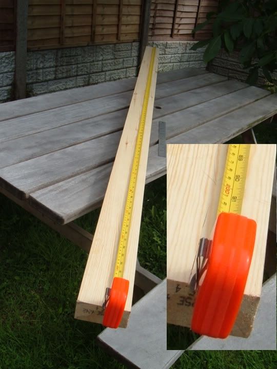

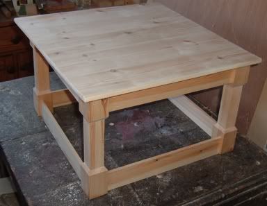

One of the woodwork forums I frequent started a competition a few months ago to see what each member could make from a standard length of 2x4 construction grade pine board.  The deadline for competition entries is Christmas Day and, although I may struggle to make the deadline, here's how my entry is progressing.
Just to prove I once had a piece of 2x4:

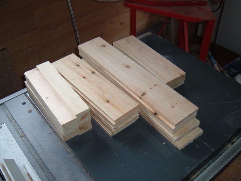

It got cut into these components:

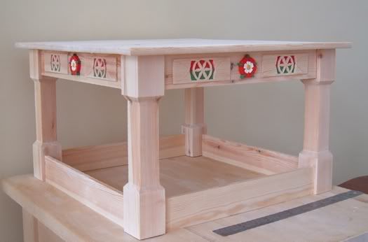

Then it was reassembled into a coffee table:

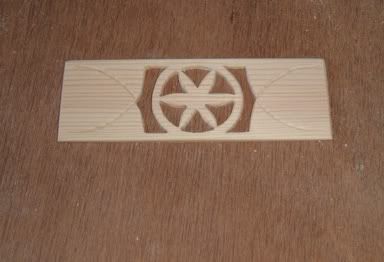

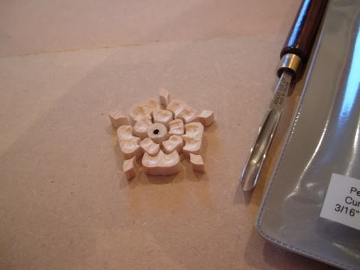

I'm going to decorate the upper rails with Tudor roses and other motifs to turn it into a Genuine Antique Tudor Coffee Table :)x :
Those motifs are still far from complete and they may not all be finished by the deadline.  Anyway, I thought I'd let everyone know what I've been up to in my workshop on those rare days when the temperature has risen above freezing.  If I seem to visit the forum less than normal over the next couple of weeks, you'll know why - I've moved out of the cold workshop and into the warm kitchen :) .

I completed it before the deadline :) .
Now I've got a new coffee table and the wood cost me less than a tenner.  That's a win in my book, no matter what the outcome of the competition :) .

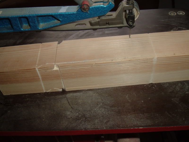

Dead brill, Gill!  I hope you'll encourage the use of drinks coasters with it.  Is each leg comprised of a single piece?
It certainly is :) .  I compound cut it on a scroll saw, and here's a 'work in progress' photo:

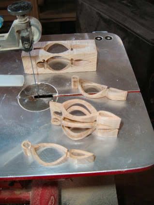

When all the cuts are complete, the outer waste wood falls away to reveal the inner shape.  It's exactly the same technique that I used to make a tree-full of Christmas decorations:
